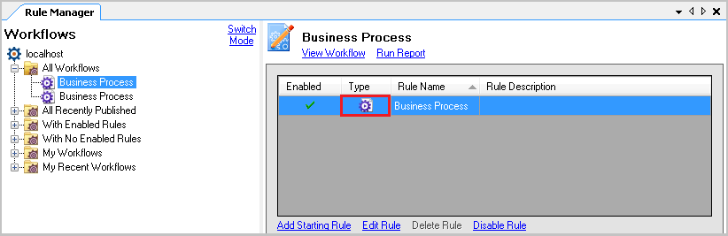

  1. If publishing a business process for the first time, the ClosedBusiness Process Rule dialog box will open automatically. To configure requirements on a published business process, open the Rule Manager Pane:
    1. Select the Rule Manager button from the Workflow Designer toolbar, or select Rule Manager from the View drop-down menu.
    2. Locate and select the business process you want to configure, and double-click the ClosedBusiness Process button.
  2. The Laserfiche Repository Login dialog box will open, login into the repository that the business process will interact with. Click OK.
  3. Once logged in, the Business Process Rules dialog box will open.

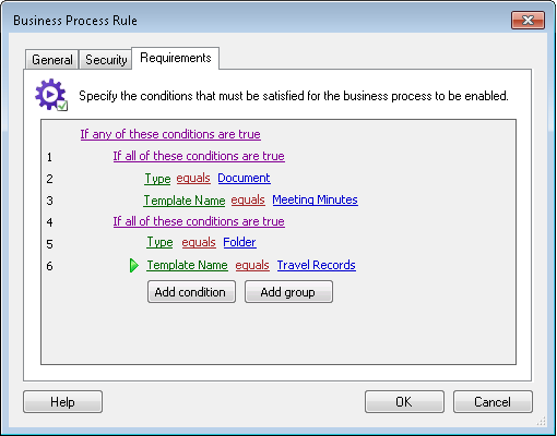

  1. Select the ClosedRequirements tab and click the No conditions set. Click here to create one link to configure conditions that must be met for the business process to be enabled in Laserfiche client applications. The conditions for business process requirements are configured in the same way as Workflow Condition Editors, however some options differ. Learn more about creating, organizing, or using tokens for conditions.
    Note: The number of groups and conditions in this tab is limited to 32 lines.
  2. When you finish configuring the requirements, select the General or Security Policy tab to continue configuring your business process. Alternatively, click OK to save your changes and close the dialog box.
